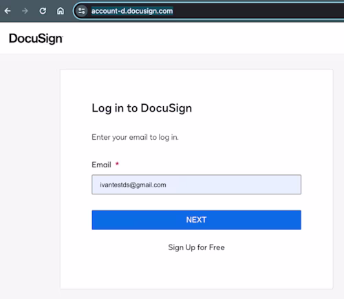

Let’s focus on the account server certificate. The endpoint or service offered behind this endpoint can quickly be seen when you attempt to log into your Docusign account. It looks like this: https://account-d.docusign.com for demo and like this: https://account.docusign.com for your production account.
You can also see this if you are using the API to authenticate to Docusign. In this image I am authenticating via JWT. For more information on the authentication methods with REST API, see eSignature REST API Authentication
As you can see in both examples, the URL includes https, which means the connection is encrypted with TLS. In some instances you may choose to validate the certificate for your custom integration. If you choose to do so, you will require the certificate offered by Docusign. This is typically renewed once a year.

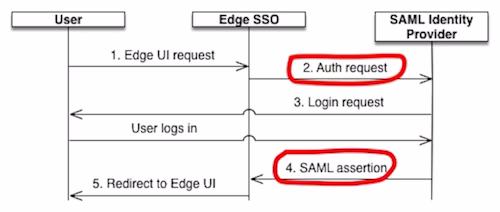

SSO certificates
In this section I’ll describe two different types of single sign-on (SSO) certificates. To keep the topic from becoming confusing, I will describe these at a very high level, but I am including some additional links for experts to dive in.
IDPprovided SSO certificate
This type of SSO certificate needs to be uploaded in Docusign Admin. This may often be mixed up with the account server certificate, which we already discussed, since both of them are related to authentication. The difference here is that the SSO certificate is used for users logging in with single sign-on, which uses SAML. This certificate is most commonly provided by your Identity provider (IDP): for example, Okta, Azure, Ping Identity, and others.
When this certificate expires, your users may lose the ability to access their Docusign accounts via SSO. Since the provider of the certificate may vary, it is important to make sure you are aware of the origins of the certificate and the expiration date so that you can update it in Docusign Admin to avoid this scenario. The certificate can be updated in Docusign Admin under the Identity provider settings.
Docusign’s optional SSO certificate
This self-signed certificate is offered on our Docusign SSO Service Provider Certificate support page. For a further discussion of this topic, see the Docusign support page Docusign SSO Cert Renewal - Action Required.
This SSO certificate is only used as a key container. We use it to contain the key for the following use cases:
SAML requests from Docusign (the Service Provider) to IDPs, also known as AuthN requests, are signed with the private key, and IDPs validate the signature using the pub key.
SAML responses from IDPs are encrypted with the public key, then we decrypt with the private key. (This is configured by the IDP)
